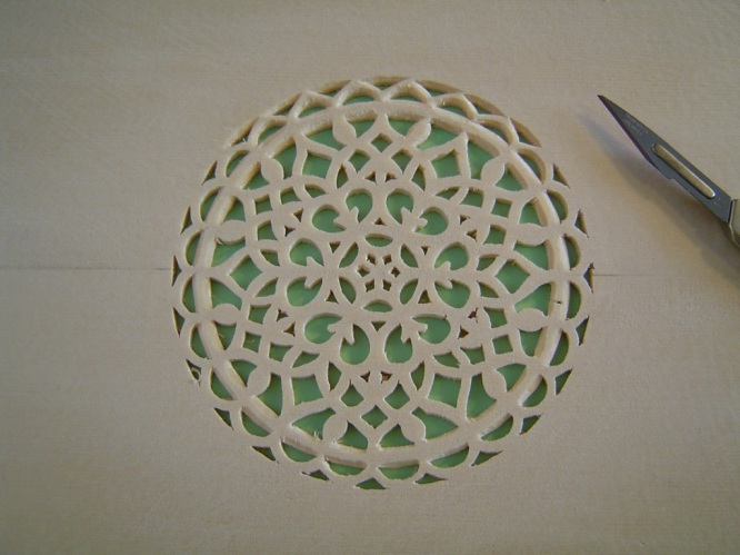

I started the scalpel carving on my latest rose, this is the bit that transforms it from fretwork to a rose. Just the initial primary facet on the outer ring so far. It's a matter of gradual refinement until the final profile is reach for each bar.
With just the template stuck on and the holes cut out with a jewellers saw bladeColin S38831.4950231481

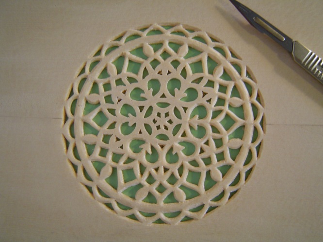

Here's an update with a few more hours work, strting to look a bit more like a rose now.

Colin, this is just marvelous workmanship sir!

That is impressive Colin. Do you begin that process with a scroll saw?

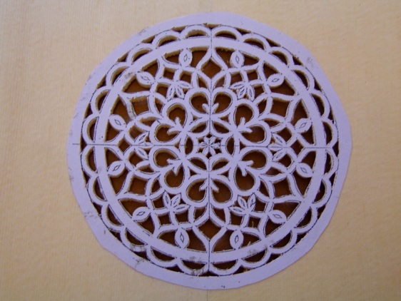

No Ron, I start by gluing a paper template on the top and drilling into the corners of the voids with a very fine drill. Then, using the blade from a jewellers saw, the sort that is used to cut pearl, I pass that through and with a hand above and below holding the blade tight saw out the unwanted wood, I use a board with a 30mm hole in it to support the top. When that's done the template is carefully sanded off and you start in with the scalpels.
It's a slow job but very therapeutic. My really complicated ones can take as long to do as the rest of the lute!

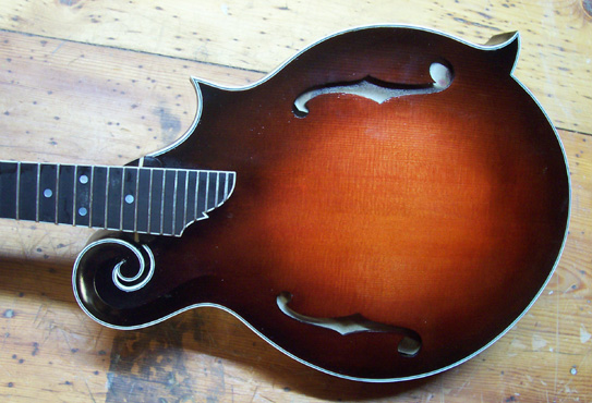

Colin, that is amazing! Can't wait to see what it will look like with a nice sunburst .

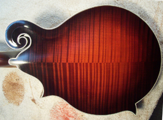

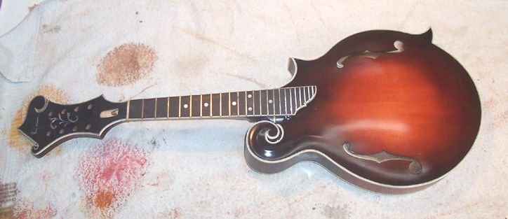

Speaking of which; here's how my F5 is looking so far. Hand rubbed water based dyes, air brushed anilines around the perimeter, sprayed shellac finish (my first). It is not as dark as the picture suggests, the wood actually shows through everywhere. It still needs final levelling and buffing after some curing time. I'm not sure how it will hold up, the finish is quite thin, but it is relatively easy to apply as long as you can avoid runs.
Back:

Front:
PostPosted: Sat Apr 22, 2006 4:44 am
The whole thing:

Beauty!

Arnt, Love that classy F5!

Arnt, just lovely and beautiful mandolin there! I'm a bit of a mandolin player myself and had a chance to try one of Mario's which sounded REALLY great BTW, looking at yours made me wonder what the sound will be like, did you use maple for the back and sides? if so, i'll bet it will sound great too!
Do you have a recording set up so we could hear how she sound when completed? An F5 mandoliN is on my list of future projects also thus explaining all my questions!

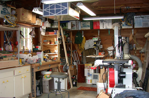

Woohooo! 4 uninterrupted hours in the shop today! No building but did a major makeover (for the shop, not me!). Added a circuit, rearranged the big tools, installed air filter, hooked up dust collector, cleaned, got lots more space. I feel much better now!

Thanks guys!
Serge, yes the back and sides are big leaf maple that I got from Larry Davis a couple of years ago. Sorry, my recording equipment has not yet entered this millium! I will get into it one of these days...
Burbank, good looking shop. Looks like a fine place to make some saw dust.

Thanks Arnt, keep us updated on the sound1
